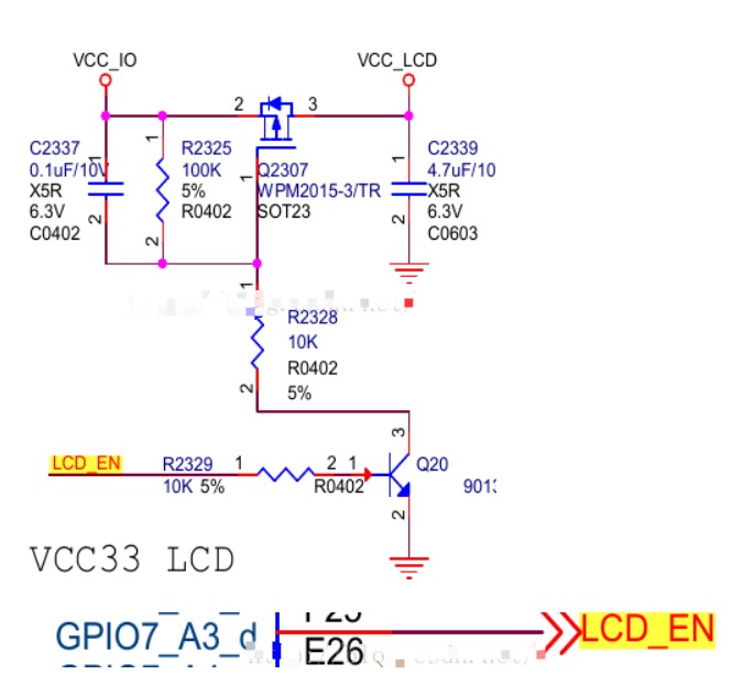

原理图屏相关部分:
1. 连接Lanes为4,软件中已经固定了.
2. 电源有VDD10_LCD, VCC18_LCD两个, 前者开机后就有,后者通过LCD_EN控制.
3. LCD_EN对应的GPIO是GPIO7_A3.

eDP的配置相当简单, 只要配置display-timing即可,另外,前面的LCD_EN引脚也要配置下.
GPIO7_A3:
&lcdc0 {
    status = "okay";
    rockchip,mirror = ;
    rockchip,cabc_mode = <0>;
    power_ctr: power_ctr {
        rockchip,debug = <0>;
        lcd_en:lcd_en {
            rockchip,power_type = ;
            gpios = <&gpio7 GPIO_A3 GPIO_ACTIVE_HIGH>;
            rockchip,delay = <10>;
