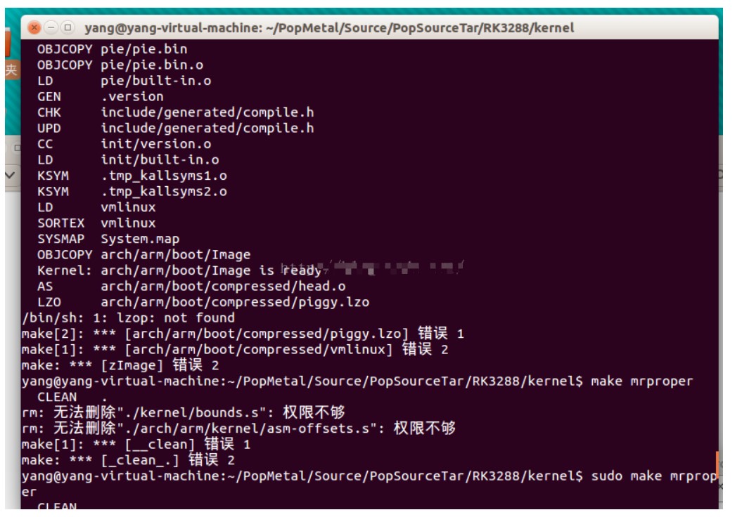

问题五:编译kernel时,提示
《span 》/bin/sh: 1: lzop: not found
make[2]: *** [arch/arm/boot/compressed/piggy.lzo] Error 1
make[1]: *** [arch/arm/boot/compressed/vmlinux] Error 2
make: *** [zImage] Error 2《/span》
根据提示安装lzop后,再次make
《span 》sudo apt-get install lzop《/span》
