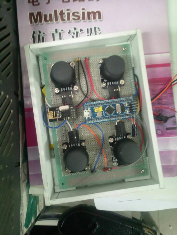

  二 这是遥控器部分的代码
  以下是遥控器部分代码
    #include "stm32f10x.h"
    #include "bsp_led.h"
#include "bsp_24l01.h"
#include "bsp_usart.h"
#include "bsp_adc.h"
u8 status;
u8 i;
extern __IO uint16_t ADC_ConvertedValue[8];
unsigned char RX_BUF5[100];
    //void Delay_ms(unsigned int ms)
//  unsigned int i,j;
// for(i=0;i
//   for(j=0;j<7;j++);
int main(void)
int value;
unsigned char temp=0;
float ADC_ConvertedValueLocal = 0.0;
USART_Config();
  ADCx_Init();
  SPI_NRF_Init();
  status = NRF_Check();
  if(status == SUCCESS)
    printf("rn      NRFÓëMCUÁ¬½Ó³É¹¦rn");
  else
    printf("rn   ÕýÔÚ¼ì²âNRFÓëMCUÊÇ·ñÕý³£Á¬½Ó¡£¡£¡£rn");
while(1)
        NRF_TX_Mode();
          RX_BUF5[0]=0xa1;
          RX_BUF5[1]=0xa2;
        RX_BUF5[2]=(char) (ADC_ConvertedValue[0]>>8);
       RX_BUF5[3]=(char) ADC_ConvertedValue[0];
      printf("rn The current AD0 value = %d V rn",ADC_ConvertedValue[0]);
       RX_BUF5[4]=(char) ADC_ConvertedValue[1];
      RX_BUF5[5]=(char) (ADC_ConvertedValue[1]>>8);
  printf("rn The current AD1 value = %d V rn",ADC_ConvertedValue[1]);
       RX_BUF5[6]=(char) ADC_ConvertedValue[2];
       RX_BUF5[7]=(char) (ADC_ConvertedValue[2]>>8);
      printf("rn The current AD2 value = %d V rn",ADC_ConvertedValue[2]);
        RX_BUF5[8]=(char) (ADC_ConvertedValue[3]>>8);
       RX_BUF5[9]=(char) ADC_ConvertedValue[3];
  printf("rn The current AD3 value = %d V rn",ADC_ConvertedValue[3]);
       RX_BUF5[10]=(char) ADC_ConvertedValue[4];
      RX_BUF5[11]=(char) (ADC_ConvertedValue[4]>>8);
  printf("rn The current AD4 value = %d V rn",ADC_ConvertedValue[4]);
       RX_BUF5[12]=(char) ADC_ConvertedValue[5];
       RX_BUF5[13]=(char) (ADC_ConvertedValue[5]>>8);
     printf("rn The current AD5 value = %d V rn",ADC_ConvertedValue[5]);
        RX_BUF5[14]=(char) (ADC_ConvertedValue[6]>>8);
       RX_BUF5[15]=(char) ADC_ConvertedValue[6];
     printf("rn The current AD6 value = %d V rn",ADC_ConvertedValue[6]);
       RX_BUF5[16]=(char) ADC_ConvertedValue[7];
      RX_BUF5[17]=(char) (ADC_ConvertedValue[7]>>8);
     printf("rn The current AD7 value = %d V rn",ADC_ConvertedValue[7]);
          RX_BUF5[18]=0xa3;
      NRF_Tx_Dat(RX_BUF5);

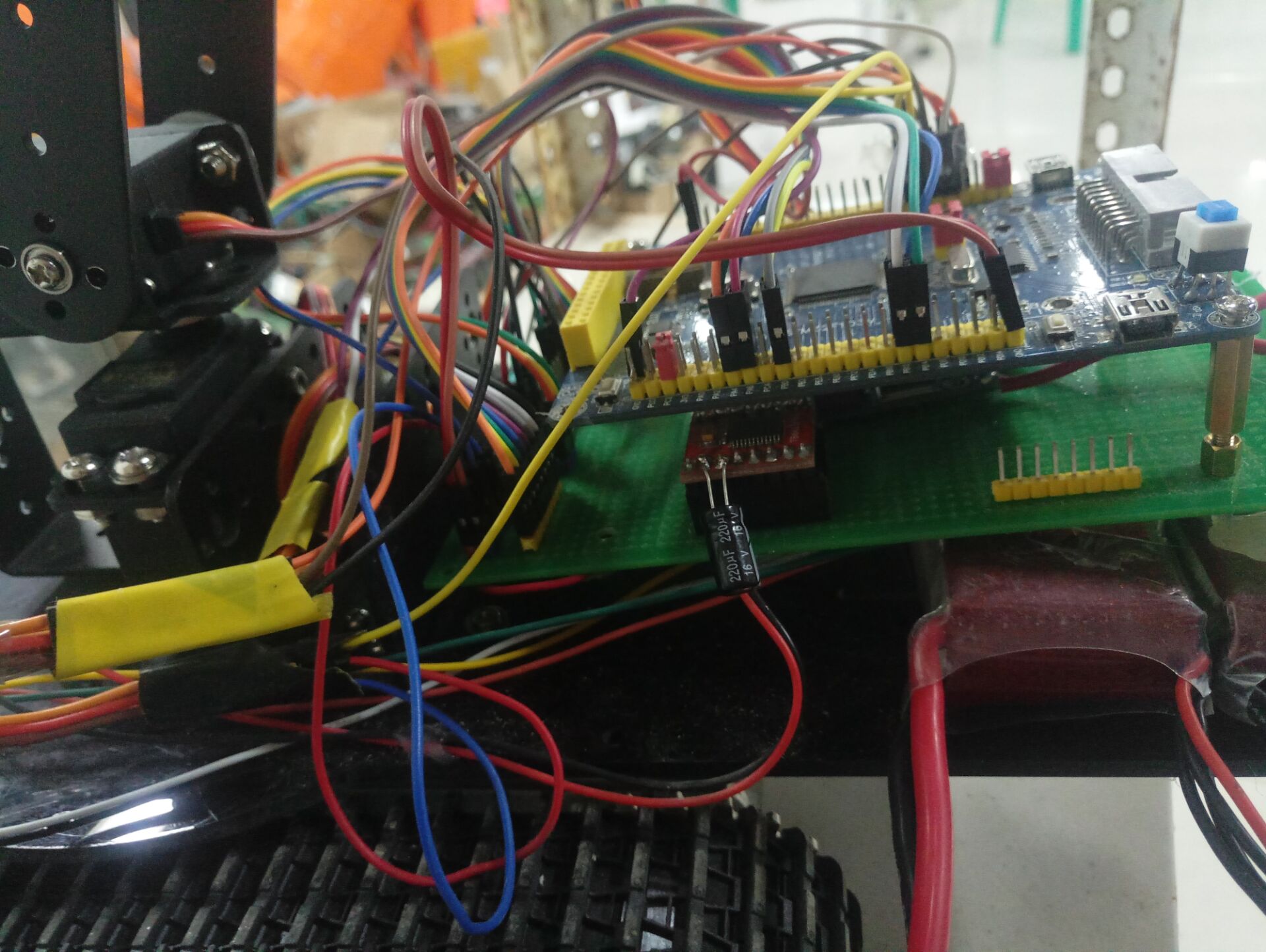

  以下是执行端部分代码
#include "bsp_TiMbase.h"
#include "pid.h"
u8 status;   //ÓÃÓÚÅжϽÓÊÕ/·¢ËÍ״̬
u8 rxbuf[1];  //½ÓÊÕ»º³å
float i=160;
float j=160;
char buf2[10] = {"0"};
unsigned char RX_Complete=0;
unsigned char RX_DataCount = 0;
union
float ADC_ConvertedValueLocal1;
  u8 txbuf[4];
}AD_Rec_data;
    int YM,ZY,SX,ONE,TWO,THREE,FOUR,FINE,SIX,SEVEN,EIGHT;
void control(void);
    //ÑÓʱº¯Êý
  unsigned int i,j;
for(i=0;i
   for(j=0;j<7;j++);
int main(void)
USART_Config();
SPI_NRF_Init();
TIM1_Config();
  TIM3_Config();
  else
       while(1)
    control();
    void control(void)
        NRF_RX_Mode();
       NRF_Rx_Dat(RX_BUF5);
  if(RX_BUF5[0]==0xa1&&RX_BUF5[1]==0xa2&&RX_BUF5[18]==0xa3)
       ZY=(RX_BUF5[2]<<8)|RX_BUF5[3];//×ó ÏÂ ÓÒ
     printf("rn The current AD1 value = %d V rn",ZY);
       YM=(RX_BUF5[5]<<8)|RX_BUF5[4];//×ó  ÏÂ ÉÏ
     printf("rn The current AD2 value = %d V rn",YM);
      SX=(RX_BUF5[7]<<8)|RX_BUF5[6];// ÓÒ ÏÂ ×ó
     printf("rn The current AD3 value = %d V rn",SX);
       ONE=(RX_BUF5[8]<<8)|RX_BUF5[9];// ÓÒ Ï  ÉÏ
       printf("rn The current AD4 value = %d V rn",ONE);
      TWO=(RX_BUF5[11]<<8)|RX_BUF5[10];//ÓÒÉÏ  ×ó
     printf("rn The current AD5 value = %d V rn",TWO);
      THREE=(RX_BUF5[13]<<8)|RX_BUF5[12];//ÓÒÉÏ    ÉÏ
     printf("rn The current AD6 value = %d V rn",THREE);
      FOUR=(RX_BUF5[14]<<8)|RX_BUF5[15];//×óÉÏ   ×ó
     printf("rn The current AD7 value = %d V rn",FOUR);
      FINE=(RX_BUF5[17]<<8)|RX_BUF5[16];//×óÉÏ   ÉÏ
     printf("rn The current AD8 value = %d V rn",FINE);
   if(YM>=2500)
    forword();//ºó
    SX=SX*2100/4096;
    TIM_SetCompare4(TIM1, YM);
   TIM_SetCompare1(TIM1, YM);//¸ù¾Ý¼ÆËãÖµÐÞ¸ÄPWMÕ¼¿Õ±È
   else
   if(YM<=1500)
      forword4();//ǰ
    YM=2100-YM*2100/4096;
    TIM_SetCompare4(TIM1, YM);//¸ù¾Ý¼ÆËãÖµÐÞ¸ÄPWMÕ¼¿Õ±È
else
    if(ZY>=2500)
    forword2();//you
      ZY=ZY*2100/4096;
   TIM_SetCompare1(TIM1, ZY);//¸ù¾Ý¼ÆËãÖµÐÞ¸ÄPWMÕ¼¿Õ±È
   TIM_SetCompare4(TIM1, ZY);
   else
   if(ZY<=1500)
    forword1();//zuo
     ZY=2100-ZY*2100/4096;
   TIM_SetCompare4(TIM1,ZY);
   TIM_SetCompare1(TIM1,ZY);
   else
   if(1500
       forword3();
    TIM_SetCompare4(TIM1, ZY);//¸ù¾Ý¼ÆËãÖµÐÞ¸ÄPWMÕ¼¿Õ±È
     TIM_SetCompare3(TIM1, ZY);
      if(ONE<=1500)//µÚÒ»¸ö¶æ»ú
    if(i<=262)
     i=i+10;
       Delay_ms(10);
        TIM_SetCompare1(TIM8,i);
      else
    if(ONE>=3500)       //22222222
    if(100
     i=i-10;
     Delay_ms(10);
   else
   if(1500
     if(TWO<=1500)//µÚ¶þ¸ö¶æ»ú
   {             //31111
    if(j<=262)
     j=j+10;
       Delay_ms(10);
        TIM_SetCompare2(TIM8,j);
      else
    if(TWO>=3500)    //322222
    if(100
    j=j-10;
     Delay_ms(10);
else
      if(1500
    if(THREE<=1500)//µÚÈý¸ö¶æ»ú   //411111
    if(j<=262)
     j=j+10;
       Delay_ms(10);
        TIM_SetCompare3(TIM8,j);
      else
    if(THREE>=3500)   ///42222
    if(100
    j=j-10;
     Delay_ms(10);
  else
      if(1500
    if(FOUR<=1500)//µÚËĸö¶æ»ú
    if(j<=262)
     j=j+10;
       Delay_ms(10);
        TIM_SetCompare4(TIM8,j);
      else
    if(FOUR>=3500)
    if(100
      j=j-10;
          Delay_ms(10);
  else
   if(1500
    if(FINE<=1500)//µÚÎå¸ö¶æ»ú
    if(j<=262)
     j=j+10;
       Delay_ms(10);
        TIM_SetCompare2(TIM1,j);
      else
    if(FINE>=3500)
    if(100
      j=j-10;
          Delay_ms(10);
   else
    if(1500
