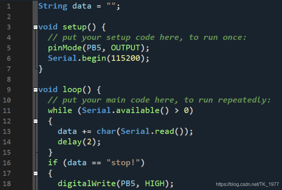

三、stduino IDE的使用体会

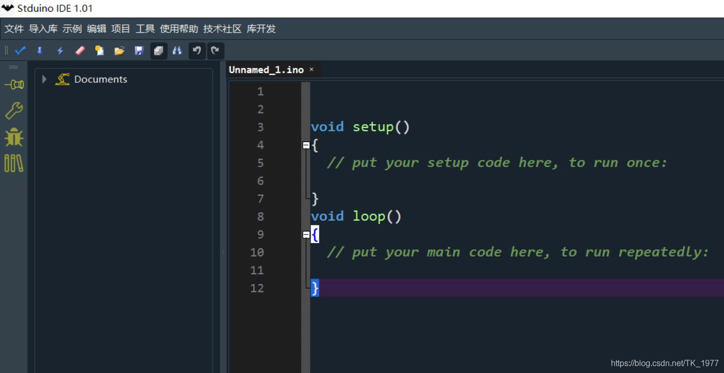

1、Stduino IDE
Stduino IDE是一款面向32位处理器快速入门学习的集成开发平台,已率先支持Arduino_Core_STM32框架,集聚快捷、高效、免费、开源、易得于一身,软件还集成了GDB调试功能!
官网界面
下载后软件界
编写程序
String data = “”;void setup() { // put your setup code here, to run once: pinMode(PB0, OUTPUT); Serial.begin(115200);}void loop() { // put your main code here, to run repeatedly: while (Serial.available() 》 0) { data += char(Serial.read()); delay(2); } if (data == “stop!”) { digitalWrite(PB0, HIGH); Serial.println(“STM32 has stopped!n”); data = “”; while(1); } digitalWrite(PB0, HIGH); //turn the LED on (HIGH is the voltage level) delay(1000); // wait for a second digitalWrite(PB0, LOW); //turn the LED off by making the voltage LOW delay(1000); // wait for a second Serial.println(“Hello World!”); delay(1000); // wait for a second}

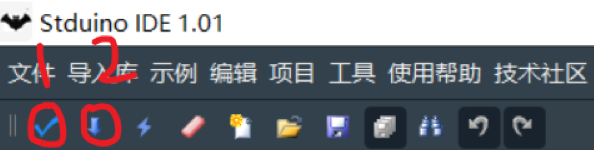

进行编译和烧录
打开串口监视器
