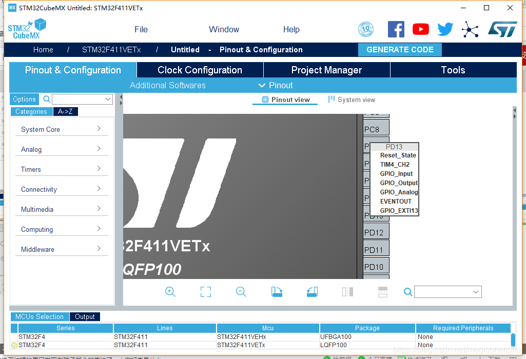

找到PD13管脚,将他设置成GPIO_OUTPUT (左键点击管脚,选择GPIO_OUTPUT)
