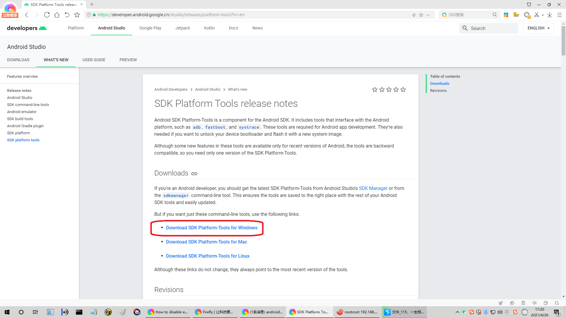

adb工具下载地址:
https://developer.android.google.cn/studio/releases/platform-tools?hl=en
But if you want just these command-line tools, use the following links:
Download SDK Platform-Tools for Windows
Download SDK Platform-Tools for Mac
Download SDK Platform-Tools for Linux
31.0.2 (April 2021)
adb
Support forwarding to vsock on linux.
Fix bug in adb track-devices where devices over wireless debugging wouldn't immediately receive updates.
Implement preliminary support for mDNS device discovery without a separately installed mDNS service. This is currently disabled by default, and can be enabled by setting the environment variable ADB_MDNS_OPENSCREEN to 1 when starting the adb server.

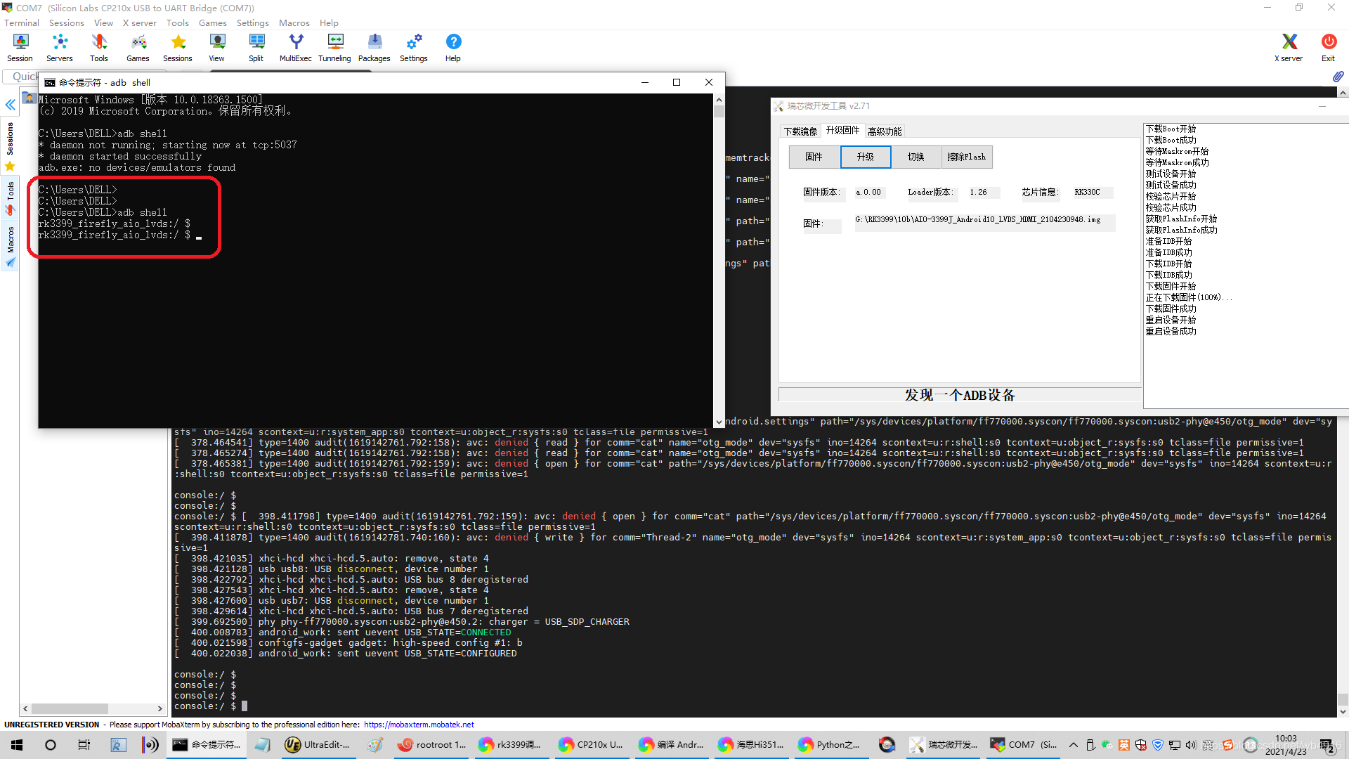

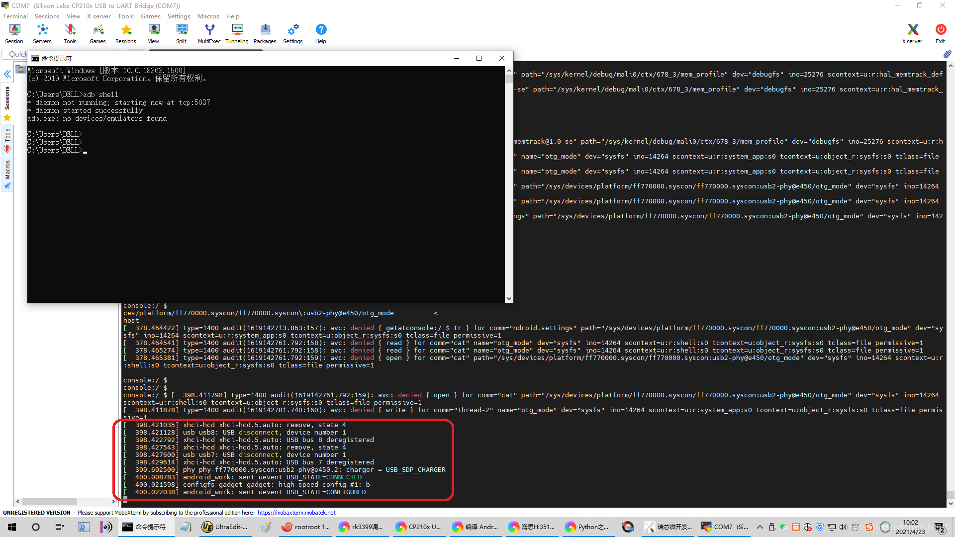

console:/ $
console:/ $ [ 3258.571344] type=1400 audit(1619416953.712:120): avc: denied { getattr } for comm="ndroid.settings" path="/sys/devices/platform/ff770000.syscon/ff770000.syscon:u***2-phy@e450/otg_mode" dev="sysfs" ino=14198 scontext=u:r:system_app:s0 tcontext=u:object_r:sysfs:s0 tclass=file permissive=1
[ 3258.571416] type=1400 audit(1619416960.643:121): avc: denied { write } for comm="Thread-2" name="otg_mode" dev="sysfs" ino=14198 scontext=u:r:system_app:s0 tcontext=u:object_r:sysfs:s0 tclass=file permissive=1
[ 3258.581380] xhci-hcd xhci-hcd.5.auto: remove, state 4
[ 3258.581462] u*** u***8: USB disconnect, device number 1
[ 3258.584348] xhci-hcd xhci-hcd.5.auto: USB bus 8 deregistered
[ 3258.589484] xhci-hcd xhci-hcd.5.auto: remove, state 4
[ 3258.589538] u*** u***7: USB disconnect, device number 1
[ 3258.591488] xhci-hcd xhci-hcd.5.auto: USB bus 7 deregistered
[ 3259.852864] phy phy-ff770000.syscon:u***2-phy@e450.2: charger = USB_SDP_CHARGER
[ 3260.169861] android_work: sent uevent USB_STATE=CONNECTED
[ 3260.187385] configfs-gadget gadget: high-speed config #1: b
[ 3260.187895] android_work: sent uevent USB_STATE=CONFIGURED
console:/ $

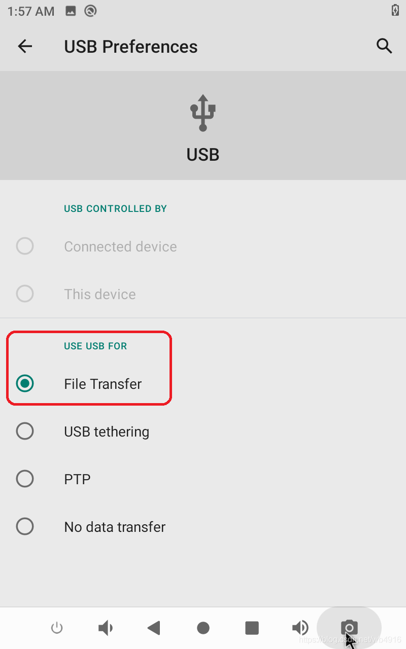

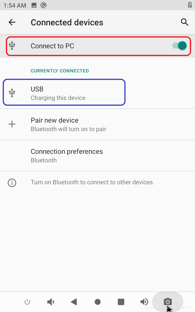

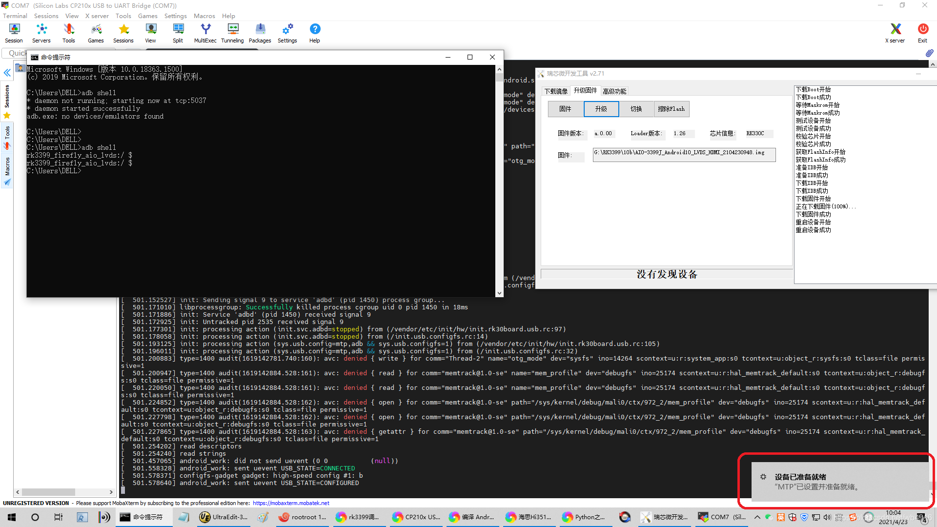

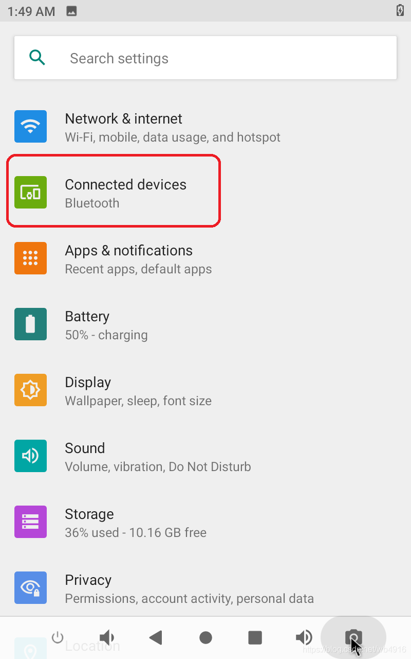

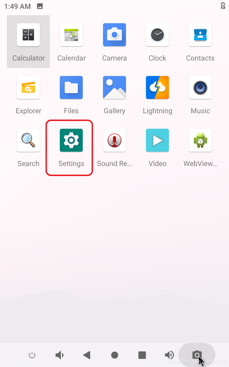

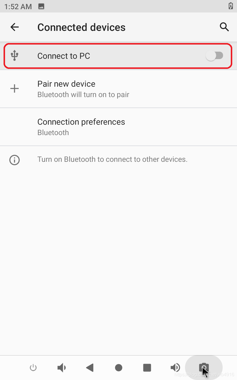

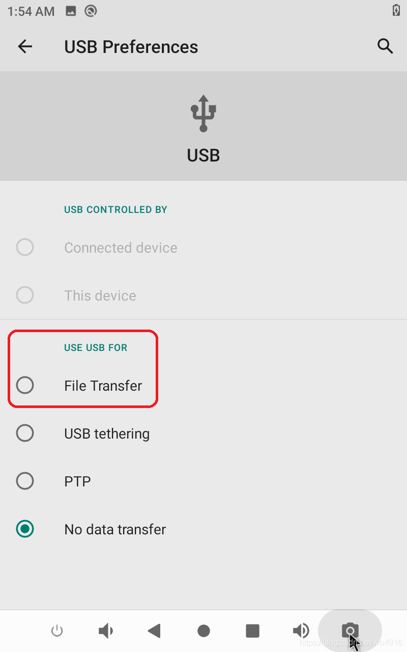

adb shell

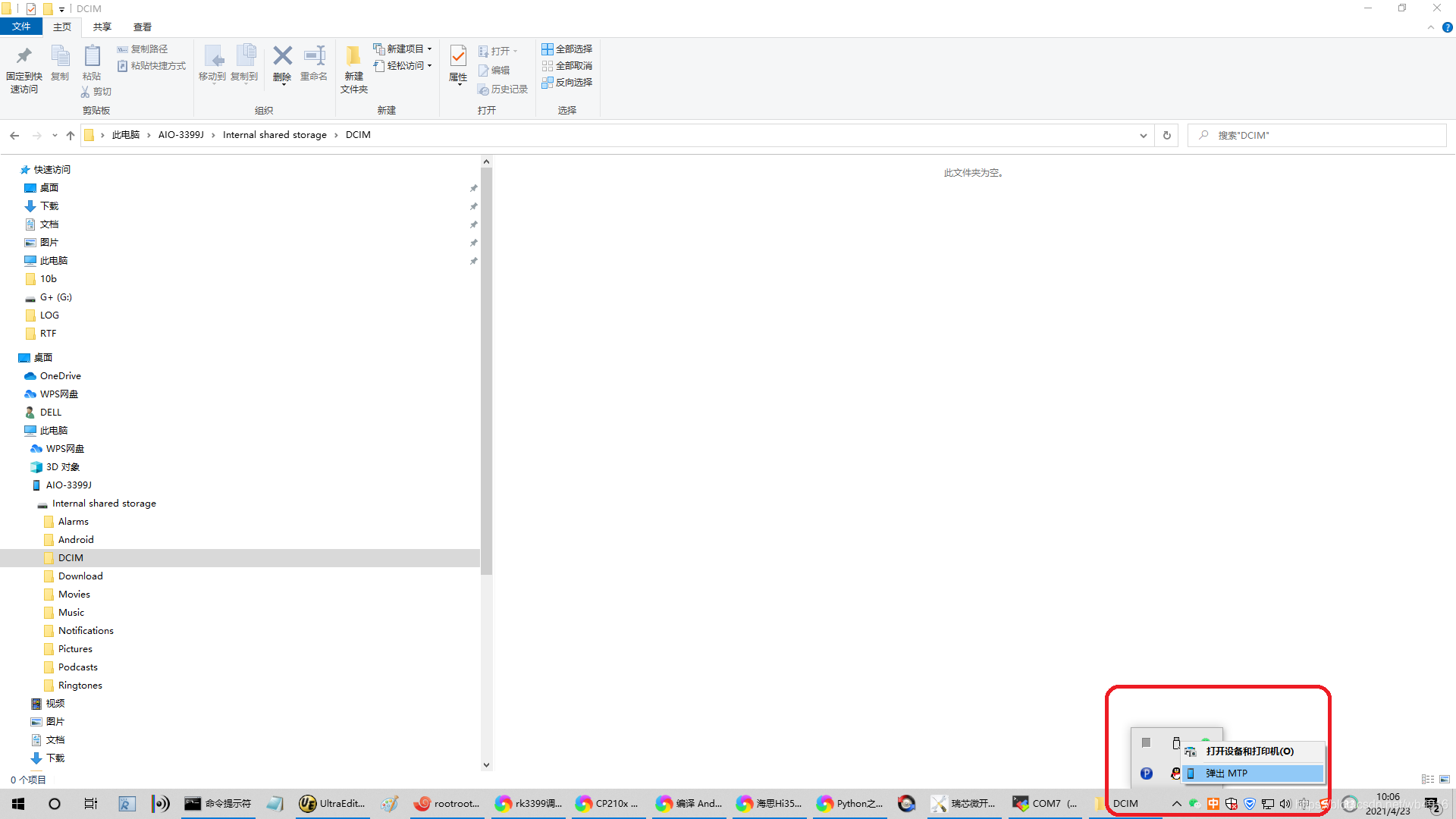

PC(WIN10)的电脑发现AIO-3399J开发板:
设备已准备就绪:
点击右下角可以:弹出MTP
现象:u***3.0接口用u***线连接电脑无法识别
