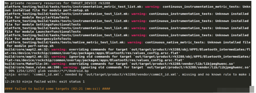

[ 99% 1254/1255] glob vendor/*/*/Android.bp
ninja: error: 'commit_id.xml', needed by 'out/target/product/rk3288/vendor/commit_id.xml', missing and no known rule to make it
12:24:53 ninja failed with: exit status 1

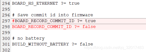

修改rk3288_android8devicerockchipcommonBoardConfig.mk
BOARD_RECORD_COMMIT_ID ?= false
