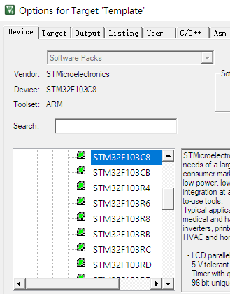

1,修改IC为STC32F103C8
![image.png](https://imgconvert.csdnimg.cn/aHR0cHM6Ly9jZG4ubmxhcmsuY29tL3l1cXVlLzAvMjAyMC9wbmcvMTU3NDYyNi8xNTkxNzk5NTM4NTkwLTFjNTdkNmNmLTZjZDUtNDNkYS1iYTE2LTUwZTlmNTdhNzE0OS5wbmc?x-oss-process=image/format,png#align=left&display=inline&height=283&margin=[object Object]&name=image.png&originHeight=420&originWidth=329&size=26988&status=done&style=none&width=222)

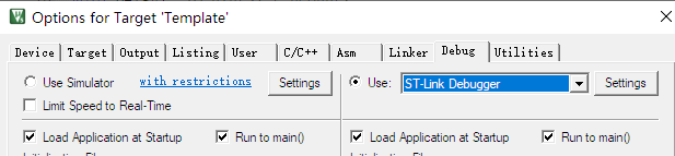

6,使用stlink调试的同学不要忘记将硬件调试换成stlink,并按settings-Flash Download-打勾Reset and Run
![image.png](https://imgconvert.csdnimg.cn/aHR0cHM6Ly9jZG4ubmxhcmsuY29tL3l1cXVlLzAvMjAyMC9wbmcvMTU3NDYyNi8xNTkxODAwMTQyMTY4LTZmYTRiYTNjLTNiNDAtNDM0My1hN2IzLTA2ZmU3OTljODc2OS5wbmc?x-oss-process=image/format,png#align=left&display=inline&height=72&margin=[object Object]&name=image.png&originHeight=143&originWidth=617&size=12530&status=done&style=none&width=308.5)
