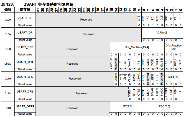

以USART1为例,解释

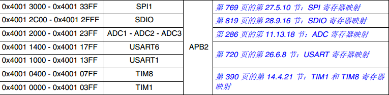

//以STM32F429IGT6为例
/** @addtogroup Peripheral_memory_map
#define PERIPH_BASE           ((uint32_t)0x40000000) /*!< Peripheral base address in the alias region
/*!< Peripheral memory map */
#define APB2PERIPH_BASE       (PERIPH_BASE + 0x00010000)
/*!< APB2 peripherals */
#define USART1_BASE           (APB2PERIPH_BASE + 0x1000)
/** @addtogroup Peripheral_declaration
#define USART1              ((USART_TypeDef *) USART1_BASE)//将USART1_BASE强转为指向USART_TypeDef类型的指针
                                                        //开辟一个以0x40000000+0x00010000+ 0x1000为地址的结构体指针
  * @brief Universal Synchronous Asynchronous Receiver Transmitter
typedef struct
        __IO uint32_t SR;         /*!< USART Status register,                   Address offset: 0x00 */
        __IO uint32_t DR;         /*!< USART Data register,                     Address offset: 0x04 */
        __IO uint32_t BRR;        /*!< USART Baud rate register,                Address offset: 0x08 */
        __IO uint32_t CR1;        /*!< USART Control register 1,                Address offset: 0x0C */
        __IO uint32_t CR2;        /*!< USART Control register 2,                Address offset: 0x10 */
        __IO uint32_t CR3;        /*!< USART Control register 3,                Address offset: 0x14 */
        __IO uint32_t GTPR;       /*!< USART Guard time and prescaler register, Address offset: 0x18 */
} USART_TypeDef;
