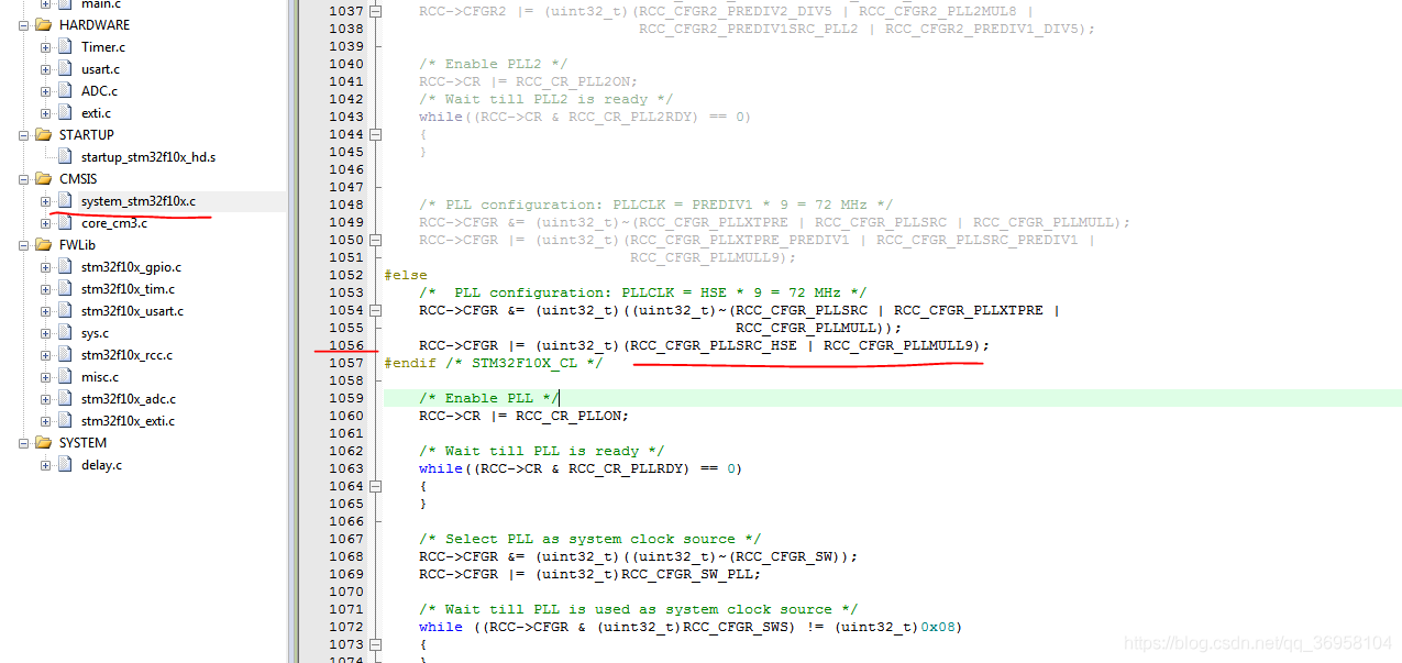

默认定义了:SYSCLK_FREQ_72MHz 72000000,也就是72M,所以这里不用改,但是,事实上,修改主频为72M的是通过
SetSysClockTo72函数实现的,该函数核心代码如下:
RCC-》CFGR &= (uint32_t)~(RCC_CFGR_PLLXTPRE | RCC_CFGR_PLLSRC | RCC_CFGR_PLLMULL);
RCC-》CFGR |= (uint32_t)(RCC_CFGR_PLLXTPRE_PREDIV1 | RCC_CFGR_PLLSRC_PREDIV1 |
RCC_CFGR_PLLMULL9);
#else
/* PLL configuration: PLLCLK = HSE * 9 = 72 MHz */
RCC-》CFGR &= (uint32_t)((uint32_t)~(RCC_CFGR_PLLSRC | RCC_CFGR_PLLXTPRE |
RCC_CFGR_PLLMULL));
RCC-》CFGR |= (uint32_t)(RCC_CFGR_PLLSRC_HSE | RCC_CFGR_PLLMULL9);
#endif /* STM32F10X_CL */
/* Enable PLL */
RCC-》CR |= RCC_CR_PLLON;其中,修改主频的核心代码为:
通过RCC_CFGR_PLLMULL9将倍频系数设置为9,如果默认外部晶振是8M,那么刚好得到72M的频率。
不过,我们修改外部晶振为12M了,所以这里得改为6,修改后代码如下:
RCC-》CFGR |= (uint32_t)(RCC_CFGR_PLLSRC_HSE | RCC_CFGR_PLLMULL6);
RCC_CFGR_PLLMULL9);
#else
RCC_CFGR_PLLMULL));
/* Enable PLL */
