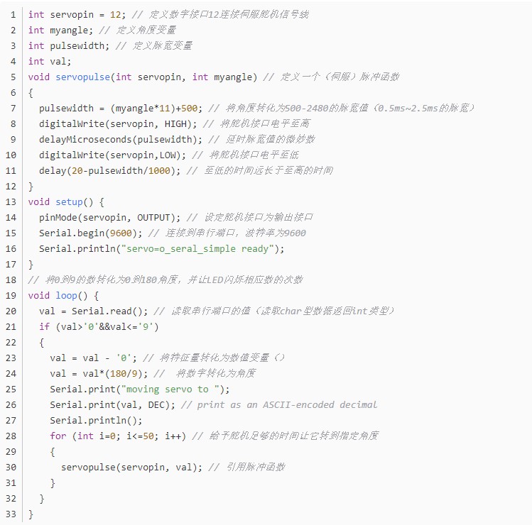

1.1 方法一:模拟产生PWM信号
将舵机接数字12接口上(这种方法不是使用analogwrite产生PWM,因此不必使用PWM口)。编写一个程序让舵机转动到用户输入数字所对应的角度数的位置,并将角度打印显示到屏幕上。

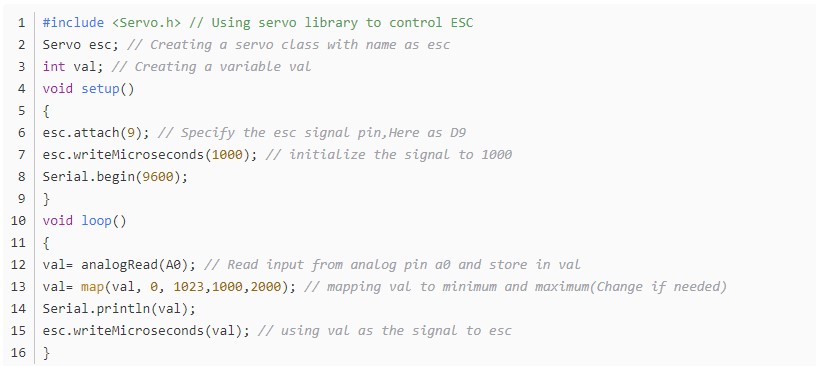

2. Arduino控制无刷电机
关于电调的控制信号:电调信号是pwm信号,信号频率为50Hz,一个周期为20ms。对于电调来讲,高电平脉宽为1ms表示停转,高电平脉宽为2ms表示满油门运转;对于舵机来说1.5ms是归中,1ms和2ms分别为左右满舵。(因此下面才直接用Servo库来给实现ESC信号的输出)。
关于Servo.write()和Servo.writeMicroseconds()
0.Servo.writeMicroseconds(): Writes a value in microseconds (uS) to the servo, controlling the shaft accordingly. On a standard servo, this will set the angle of the shaft. On standard servos a parameter value of 1000 is fully counter-clockwise, 2000 is fully clockwise, and 1500 is in the middle.
1.servo.write() allows a maximum of 180 servo positions
servo.writeMicroseconds() allows a maximum of 1000 servo positions
2.The “write” method simply maps the “degrees” to microseconds and calls the “writeMicroseconds” method anyway.
The “degree” of turn is simply a convenient abstraction, and few bother to calibrate it.
控制程序:
补充:电调1ms停转,2ms满油门运转,是指的单向电调,且是方波脉冲。而一般双向电调,1ms反转最大油门,1.5油门中点,2ms满油门正转。
