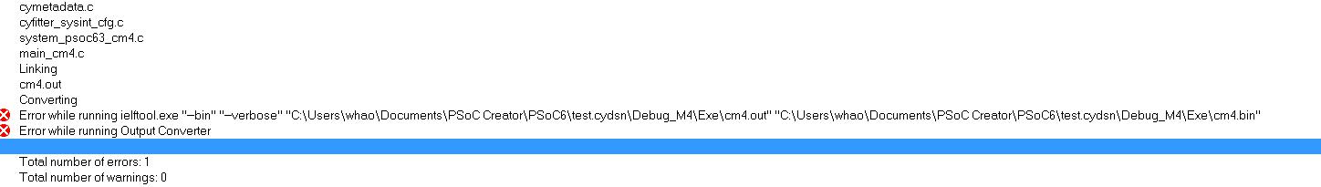

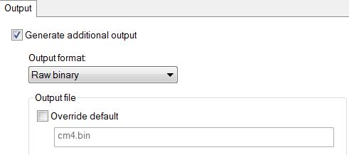

我发现生成原始二进制文件对于PSoC6的IAR有问题。我为CM0+和CM4创建测试项目,添加IAR项目连接,构建CM0PLUS项目,然后CM4项目。在IAR中为CM4项目选择转换为原始二进制文件,然后生成。
但是我看到Project Bube在转换成原始二进制时永远不会结束,我不得不手动点击Ctrl +C来结束这个。然后我看到下面的日志。当我检查输出时,我看到CM4.Bin现在非常大,消耗超过1.8GB。所以,如果我不结束转换,它将消耗我所有的磁盘空间!

  I found generating raw binary has problem with IAR for PSoC6. I created test projects for both cm0+ and cm4, add IAR project connections, build cm0plus project, then cm4 project. Choose conversion to raw binary in IAR for CM4 project then build.
But I see project build never end when converting to raw binary, I had to manually hit Ctrl+C to end this. Then I see the following log. When I check the output, I did see cm4.bin which is now very big, consuming over 1.8GB. So if I do not end the conversion, it will consume all my disk space!

在IAR EWB中,我能够成功地为PSoC 6 MCU项目生成原始二进制文件。我使用的是IAR EWB V820.1。不过,生成的二进制文件似乎很大。
请检查项目设置。我遵循了在建立PSoC Creator帮助文档的PSoC 6 IAR项目部分中提供的步骤来建立IAR项目。

  I'm able to successfully generate the Raw binary for PSoC 6 MCU project in IAR EWB. I'm using the IAR EWB v8.20.1. Generated binary file seems to be large though.
Please check your project settings. I followed the steps provided in Setting up a PSoC 6 IAR Project section of PSoC Creator Help document to set up the IAR project.
