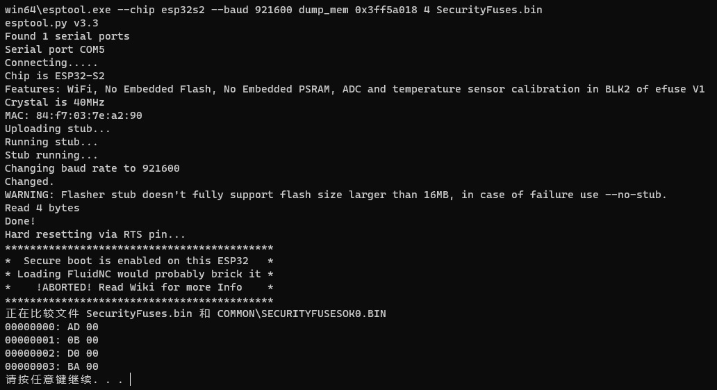

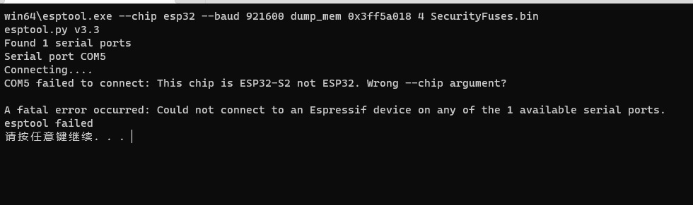

在运行安装脚本的时候,提示我芯片是esp32-s2,而不是esp32,无法继续烧写
然后我修改了一下他的安装脚本,把里面的esp32改成了esp32s2
又出现了新的错误

It appears to have eFuses set. Several people have bricked their ESP32s by trying to flash when eFuses are set. Our install scripts will not install on chips with eFuses set.
