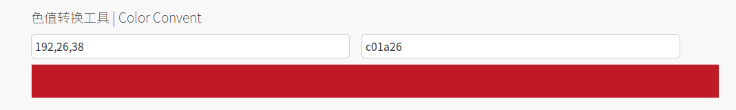

红色背景:
  # cat color_sensor
r:192 g:26 b:38

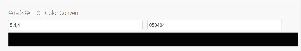

黑色背景:
  # cat color_sensor
r:5 g:4 b:4

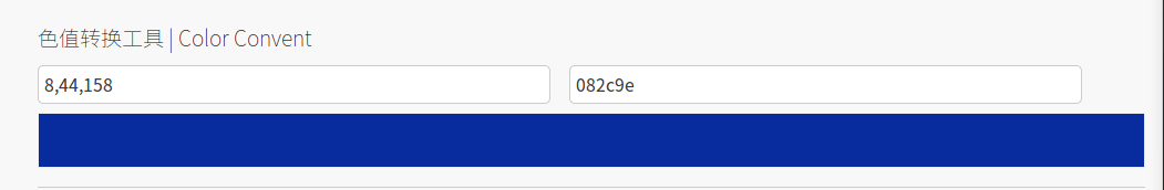

蓝色背景:
  # cat color_sensor
r:8 g:44 b:158

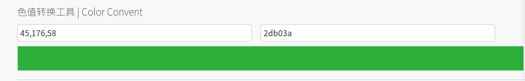

绿色背景:
  # cat color_sensor
r:45 g:176 b:58

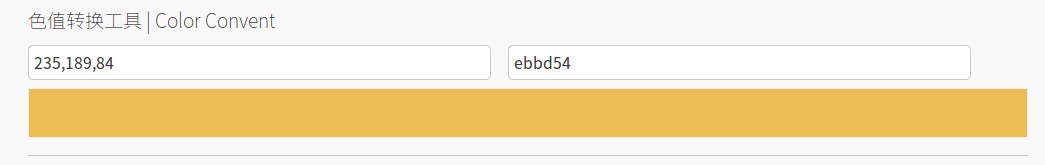

黄色背景:
  # cat color_sensor
r:235 g:189 b:84
