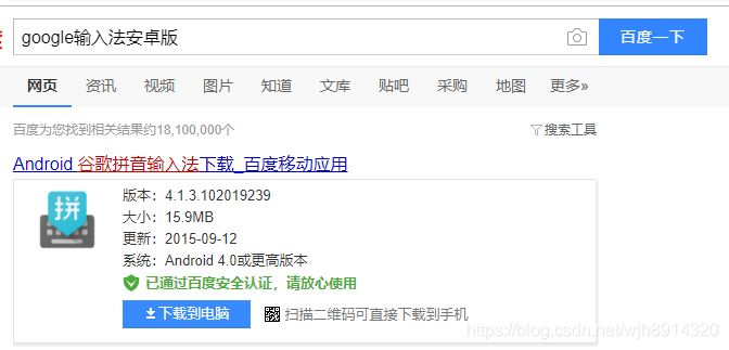

系统原来的输入法不带中文输入。所以下载带中文的Google输入法(好处是不带广告)。
下载地址方式:

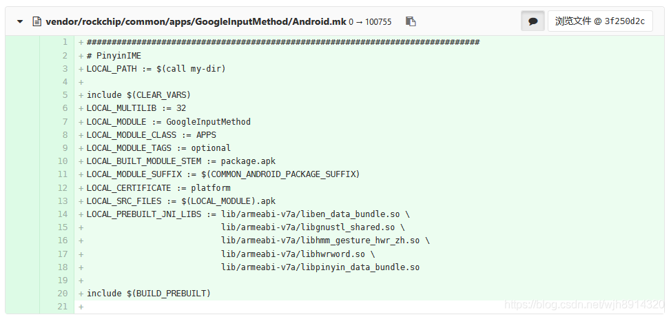

1、新建vendor/rockchip/common/apps/GoogleInputMethod目录。并将输入法改名GoogleInoutMethod.apk拷贝进去.
2、新建Android.mk
diff --git a/vendor/rockchip/common/apps/GoogleInputMethod/Android.mk b/vendor/rockchip/common/apps/GoogleInputMethod/Android.mk
new file mode 100755
index 0000000..09687ea
--- /dev/null
+++ b/vendor/rockchip/common/apps/GoogleInputMethod/Android.mk
@@ -0,0 +1,21 @@
+# PinyinIME
+LOCAL_PATH := $(call my-dir)
+include $(CLEAR_VARS)
+LOCAL_MULTILIB := 32
+LOCAL_MODULE := GoogleInputMethod
+LOCAL_MODULE_CLASS := APPS
+LOCAL_MODULE_TAGS := optional
+LOCAL_BUILT_MODULE_STEM := package.apk
+LOCAL_MODULE_SUFFIX := $(COMMON_ANDROID_PACKAGE_SUFFIX)
+LOCAL_CERTIFICATE := platform
+LOCAL_SRC_FILES := $(LOCAL_MODULE).apk
+LOCAL_PREBUILT_JNI_LIBS := lib/armeabi-v7a/liben_data_bundle.so
+ lib/armeabi-v7a/libgnustl_shared.so
+ lib/armeabi-v7a/libhmm_gesture_hwr_zh.so
+ lib/armeabi-v7a/libhwrword.so
+ lib/armeabi-v7a/libpinyin_data_bundle.so
+include $(BUILD_PREBUILT)

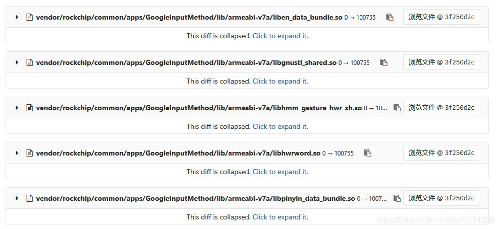

3、将Google输入法的so库单独考出来。可使用rar等工具直接打开APK文件,直接将SO考出来,放入目录。

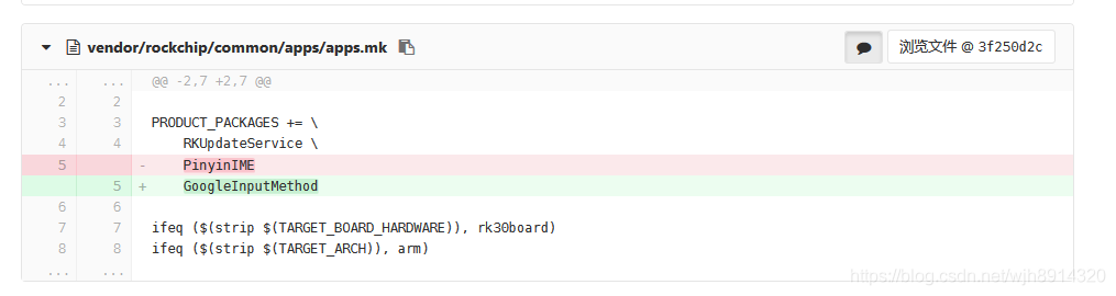

4、指定编译文件,将输入法编译进系统。

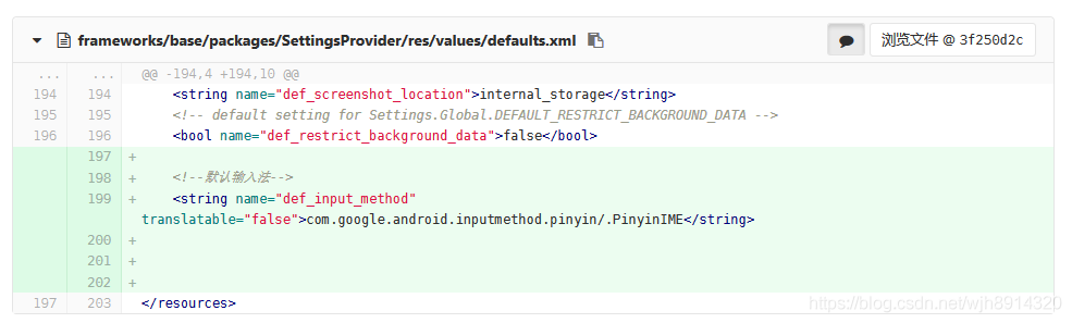

系统默认输入法指定问google输入法
diff --git a/frameworks/base/packages/SettingsProvider/res/values/defaults.xml b/frameworks/base/packages/SettingsProvider/res/values/defaults.xml
index 6a646cd..98805d5 100755
--- a/frameworks/base/packages/SettingsProvider/res/values/defaults.xml
+++ b/frameworks/base/packages/SettingsProvider/res/values/defaults.xml
@@ -194,4 +194,10 @@
internal_storage
false
com.google.android.inputmethod.pinyin/.PinyinIME

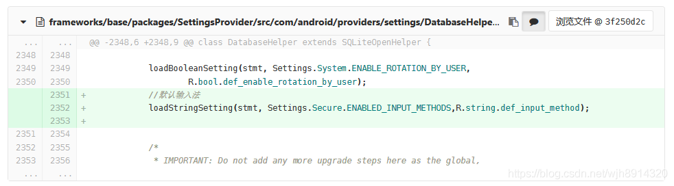

diff --git a/frameworks/base/packages/SettingsProvider/src/com/android/providers/settings/DatabaseHelper.java b/frameworks/base/packages/SettingsProvider/src/com/android/providers/settings/DatabaseHelper.java
index 858babe..211c77a 100644
--- a/frameworks/base/packages/SettingsProvider/src/com/android/providers/settings/DatabaseHelper.java
+++ b/frameworks/base/packages/SettingsProvider/src/com/android/providers/settings/DatabaseHelper.java
@@ -2348,6 +2348,9 @@ class DatabaseHelper extends SQLiteOpenHelper {
loadBooleanSetting(stmt, Settings.System.ENABLE_ROTATION_BY_USER,
R.bool.def_enable_rotation_by_user);
+ //默认输入法
+ loadStringSetting(stmt, Settings.Secure.ENABLED_INPUT_METHODS,R.string.def_input_method);
* IMPORTANT: Do not add any more upgrade steps here as the global,
