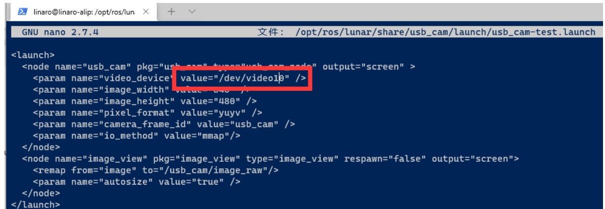

修改u***_cam-test.launch中的video_device :
sudo nano /opt/ros/lunar/share/u***_cam/launch/u***_cam-test.launch

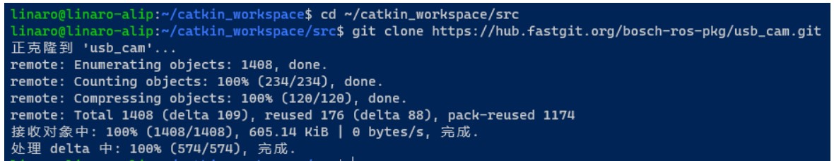

下载u***_cam源码
cd ~/catkin_workspace/src
git clone https://hub.fastgit.org/bosch-ros-pkg/u***_cam.git
source ./devel/setup.bash

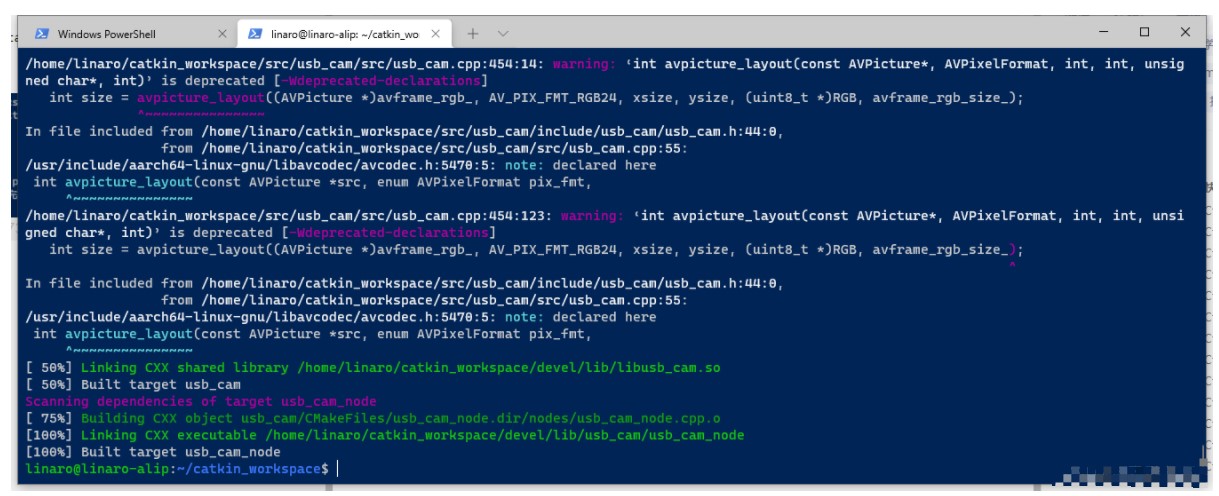

编译
catkin_make

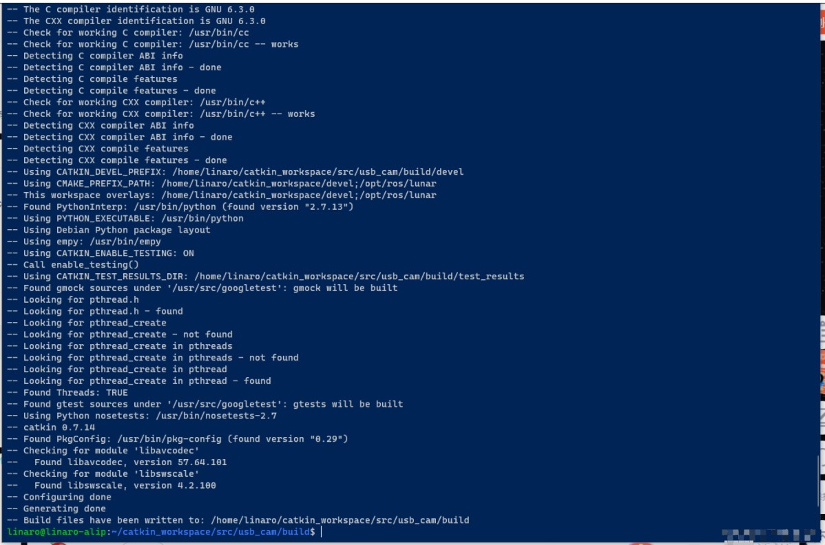

cd ~/catkin_workspace/src/u***_cam
mkdir build
cd build
cmake ..
make

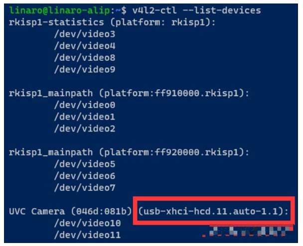

v4l2-ctl --list-devices
检测设备:
可见UVC摄像头是/dev/video10或/dev/video11

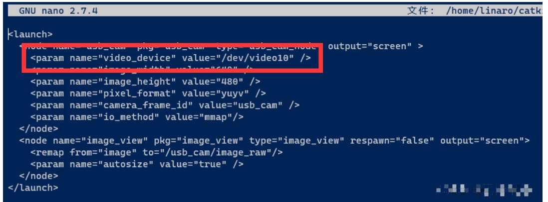

sudo nano ~/catkin_workspace/src/u***_cam/launch/u***_cam-test.launch

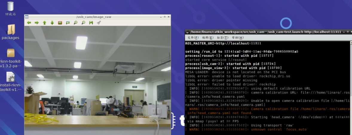

打开新的终端,进入launch文件夹,再运行u***_cam中的launch文件,如果可以成功运行看到图像则安装成功
cd ~/catkin_workspace/src/u***_cam/launch
source ~/catkin_workspace/devel/setup.bash
roslaunch u***_cam u***_cam-test.launch

下载u***_cam源码
编译
catkin_make
mkdir build
cd build
cmake ..
make

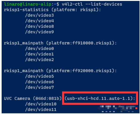

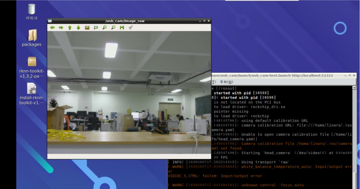

检测设备:
