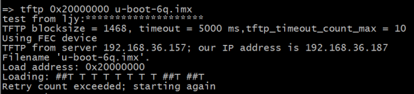

问题:uboot2016下,能ping通我的tftp服务器,但是tftp下载文件,却是断断续续(一会成功一会超时)的失败。另外nfs挂起根文件系统也是ok的,就是tftp不行。
请问怎么解决?
//摘录:
=> tftp 0x20000000 u-boot-6q.imx
test from ljy:********************
TFTP blocksize = 1468, timeout = 5000 ms,tftp_timeout_count_max = 10
Using FEC device
TFTP from server 192.168.36.157; our IP address is 192.168.36.187
Filename 'u-boot-6q.imx'.
Load address: 0x20000000
Loading: T ###T #T T T T T T T ##T
Retry count exceeded; starting again
