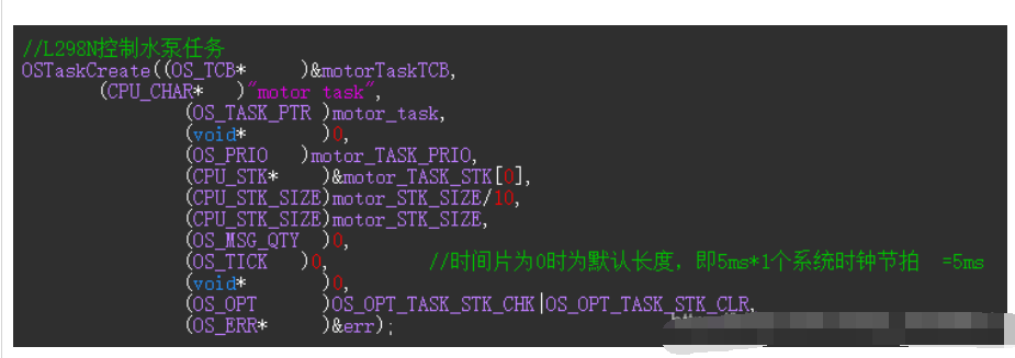

后来我就把两个两个任务的时间片轮都调大,L298n的改成120个时间片轮,也就是600ms,
        //L298N控制水泵任务
        OSTaskCreate((OS_TCB*     )&motorTaskTCB,
                                 (CPU_CHAR*   )"motor task",
                 (OS_TASK_PTR )motor_task,
                 (void*       )0,
                 (OS_PRIO          )motor_TASK_PRIO,
                 (CPU_STK*    )&motor_TASK_STK[0],
                 (CPU_STK_SIZE)motor_STK_SIZE/10,
                 (CPU_STK_SIZE)motor_STK_SIZE,
                 (OS_MSG_QTY  )0,
                 (OS_TICK          )120,                                  //时间片为0时为默认长度,即5ms*1个系统时钟节拍        =5ms
                 (void*       )0,
                 (OS_OPT      )OS_OPT_TASK_STK_CHK|OS_OPT_TASK_STK_CLR,
                 (OS_ERR*     )&err);
L298n的任务块

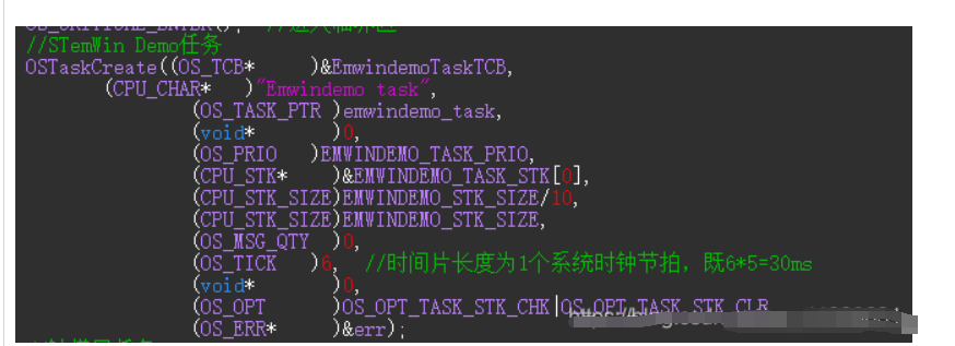

emwin的时间片轮改成2个系统时钟节拍,10ms
        //STemWin Demo任务
        OSTaskCreate((OS_TCB*     )&EmwindemoTaskTCB,
                                 (CPU_CHAR*   )"Emwindemo task",
                 (OS_TASK_PTR )emwindemo_task,
                 (void*       )0,
                 (OS_PRIO          )EMWINDEMO_TASK_PRIO,
                 (CPU_STK*    )&EMWINDEMO_TASK_STK[0],
                 (CPU_STK_SIZE)EMWINDEMO_STK_SIZE/10,
                 (CPU_STK_SIZE)EMWINDEMO_STK_SIZE,
                 (OS_MSG_QTY  )0,
                 (OS_TICK          )2,  //时间片长度为1个系统时钟节拍,既2*5=10ms
                 (void*       )0,
                 (OS_ERR*     )&err);
emwin的任务块
