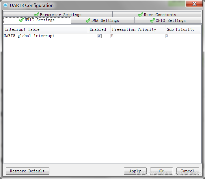

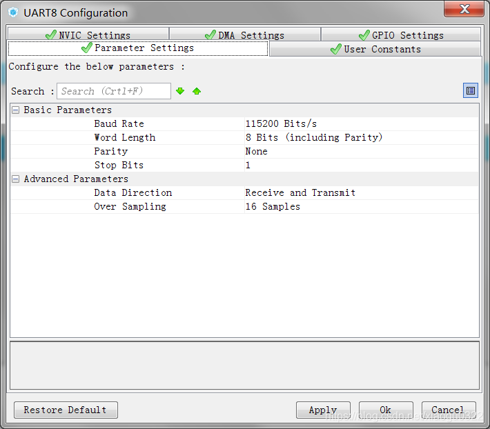

MCU使用STM32F427,串口配置用图说明(偷个懒)。

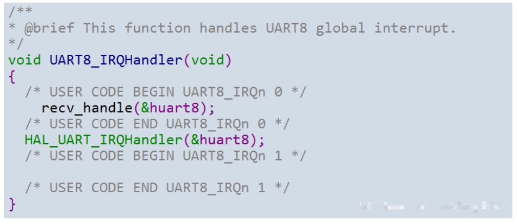

在主函数初始化中,除开cube自动生成的串口初始化外,还需额外调用指明接收buffer[size]和使能空闲中断接收。
HAL_UART_Receive_IT(&huart8,recv_buffer, USART_RX_SIZE);//指明接收buffer和size
__HAL_UART_ENABLE_IT(&huart8, UART_IT_IDLE);//开启空闲中断
/* 中断接收数据处理过程 */
void recv_handle(UART_HandleTypeDef *huart)
uint16_t length = 0;
    if ( __HAL_UART_GET_FLAG(huart, UART_FLAG_IDLE))
__HAL_UART_CLEAR_IDLEFLAG(huart);
        if (huart->RxState == HAL_UART_STATE_BUSY_RX)
            /* Disable RXNE, PE and ERR (Frame error, noise error, overrun error) interrupts */
            CLEAR_BIT(huart->Instance->CR1, (USART_CR1_RXNEIE | USART_CR1_PEIE));
            CLEAR_BIT(huart->Instance->CR3, USART_CR3_EIE);
            /* At end of Rx process, restore huart->RxState to Ready */
            huart->RxState = HAL_UART_STATE_READY;
        length = USART_RX_SIZE - huart->RxXferCount;
   //数据处理,写入缓存区
   for (uint8_t i; i < length; i++)
   printf("%d", recv_buffer);
recv_flag = true;
HAL_UART_Receive_IT(huart, recv_buffer, USART_RX_SIZE);
