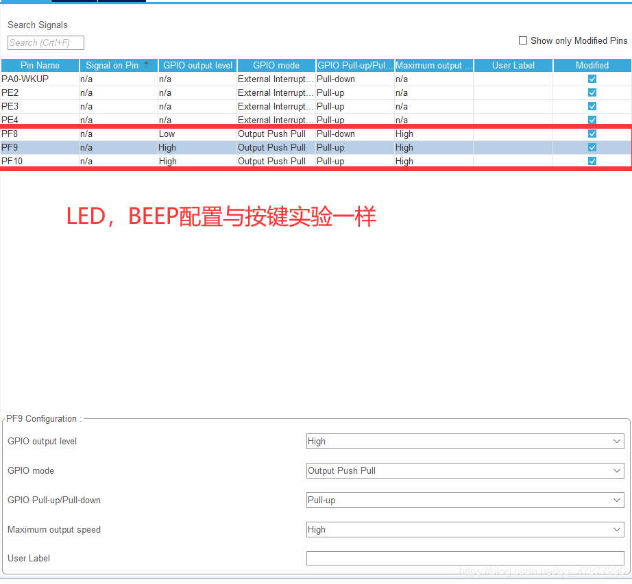

1、根据原子实验,外部中断是以按键触发,所以LED、BEEP的配置跟按键实验相同。

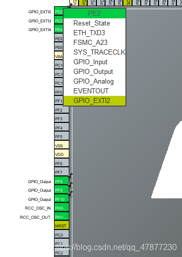

2、对于四个按键,在图示区分别点击中断配置GPIO_EXTIX

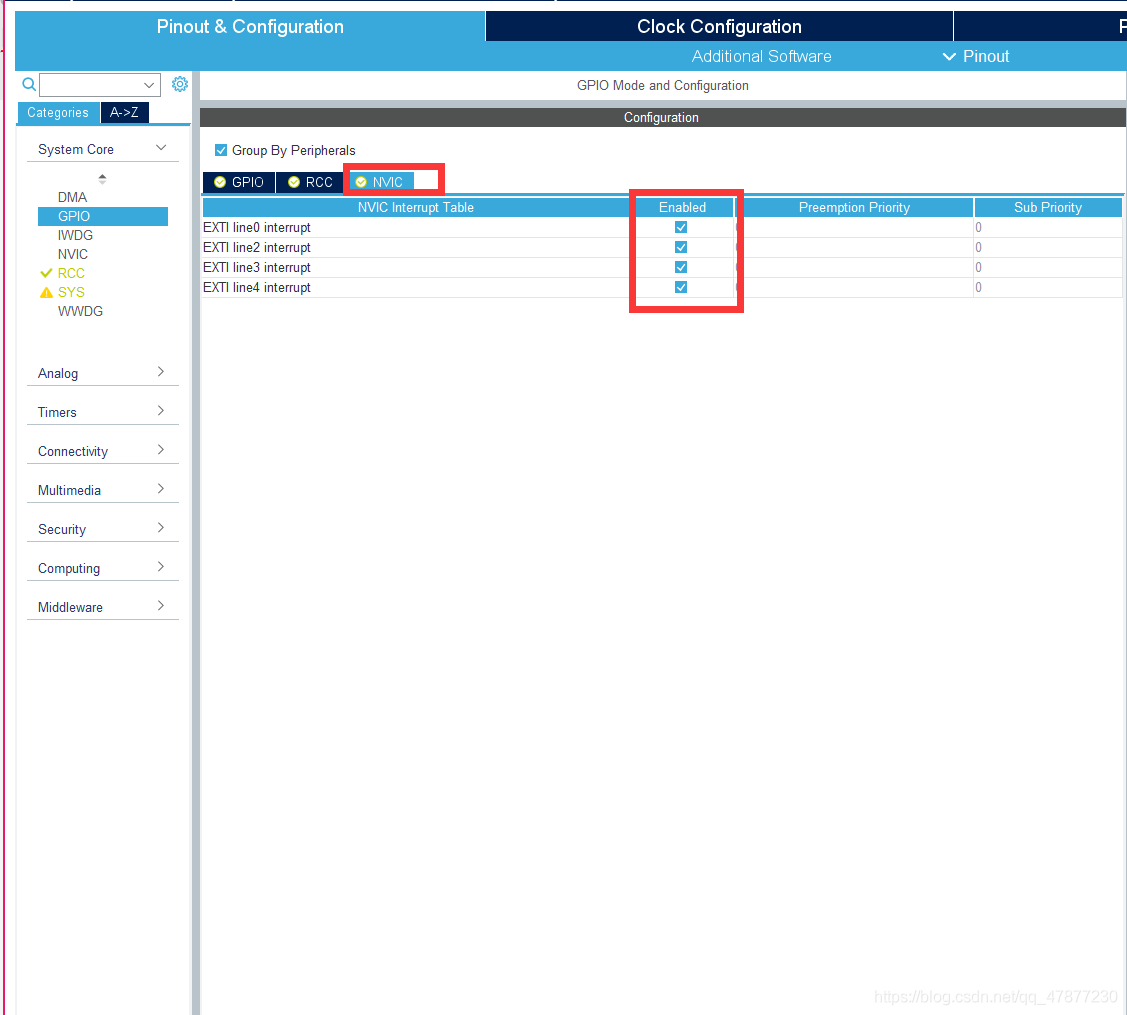

4、在GPIO的NVIC选项中,使能四根中断线

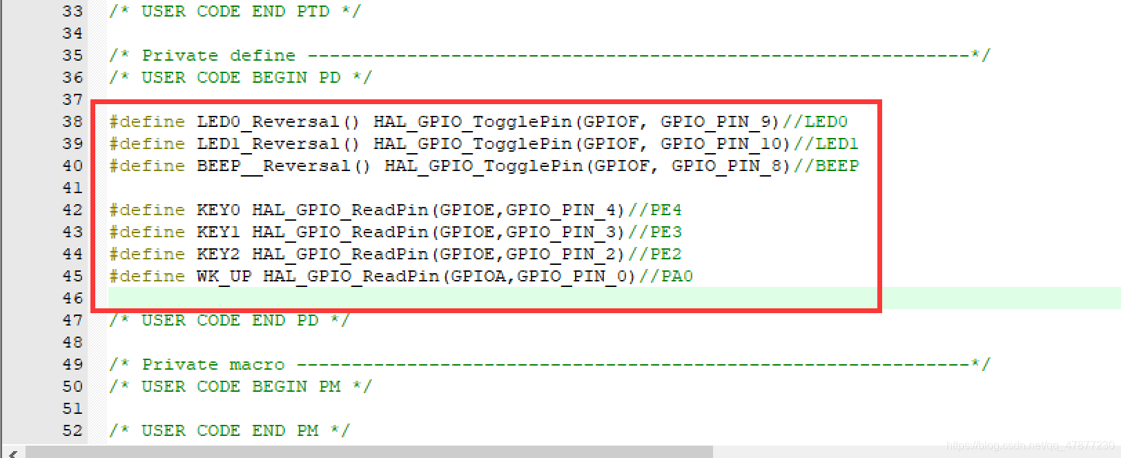

1、为了可读性更高,同样采用Define定义的方式
#define LED0_Reversal() HAL_GPIO_TogglePin(GPIOF, GPIO_PIN_9)//LED0
#define LED1_Reversal() HAL_GPIO_TogglePin(GPIOF, GPIO_PIN_10)//LED1
#define BEEP__Reversal() HAL_GPIO_TogglePin(GPIOF, GPIO_PIN_8)//BEEP
#define KEY0 HAL_GPIO_ReadPin(GPIOE,GPIO_PIN_4)//PE4
#define KEY1 HAL_GPIO_ReadPin(GPIOE,GPIO_PIN_3)//PE3
#define KEY2 HAL_GPIO_ReadPin(GPIOE,GPIO_PIN_2)//PE2
#define WK_UP HAL_GPIO_ReadPin(GPIOA,GPIO_PIN_0)//PA0

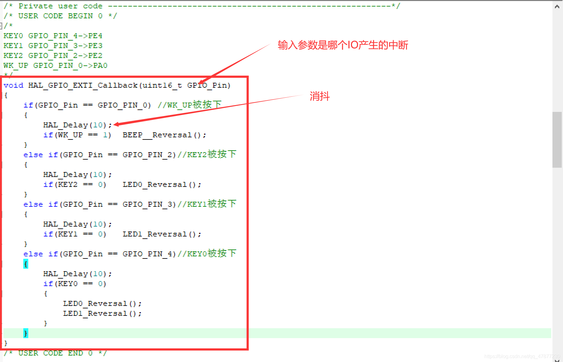

2、在main.c中添加中断服务函数
KEY0 GPIO_PIN_4->PE4
KEY1 GPIO_PIN_3->PE3
KEY2 GPIO_PIN_2->PE2
WK_UP GPIO_PIN_0->PA0
void HAL_GPIO_EXTI_Callback(uint16_t GPIO_Pin)
if(GPIO_Pin == GPIO_PIN_0) //WK_UP被按下
HAL_Delay(10);
if(WK_UP == 1) BEEP__Reversal();
else if(GPIO_Pin == GPIO_PIN_2)//KEY被按下
HAL_Delay(10);
if(KEY2 == 0) LED0_Reversal();
else if(GPIO_Pin == GPIO_PIN_3)//KEY1被按下
HAL_Delay(10);
if(KEY1 == 0) LED1_Reversal();
else if(GPIO_Pin == GPIO_PIN_4)//KEY0被按下
HAL_Delay(10);
if(KEY0 == 0)
LED0_Reversal();
LED1_Reversal();

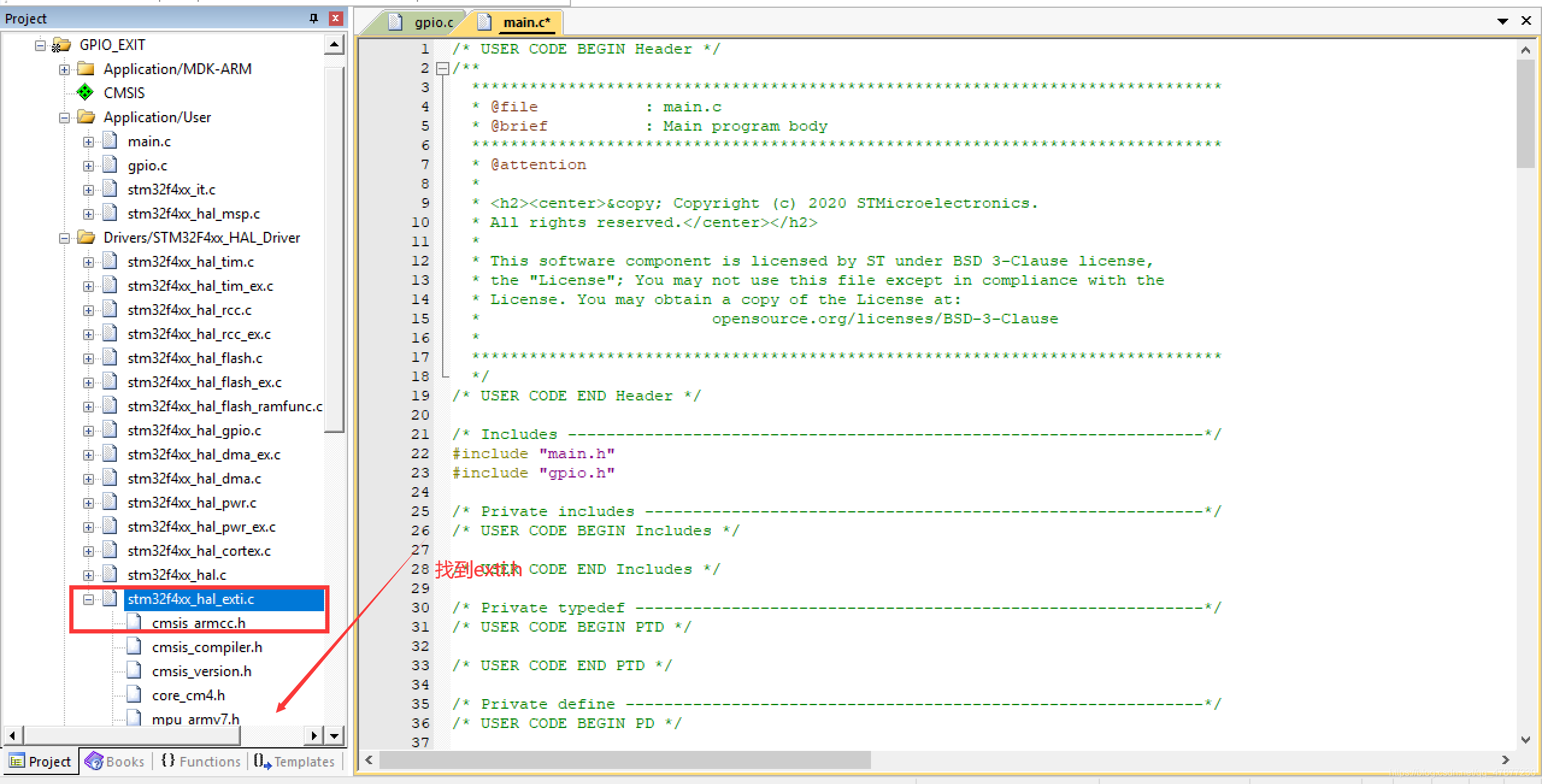

问:GPIO的操作函数在哪?
答:找到gpio.h,底端有函数供您选择。
