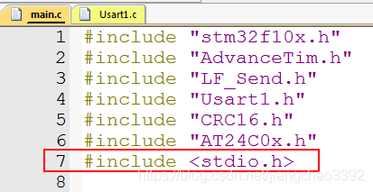

1.添加包含printf()函数的头文件:#include “stdio.h”
1-1,在Uart1.c文件中要添加#include “stdio.h”
1-2,在main.c文件中也要添加#include “stdio.h”
