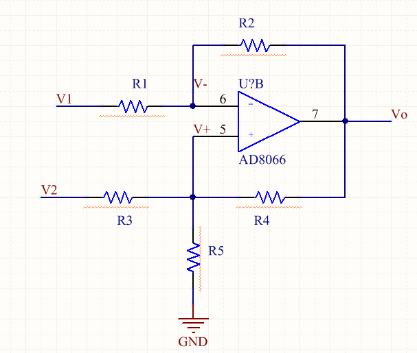

运放电流源:
运放采用AD8066,供电电压在+-12V到+-15V之间
实际应用时,一定要根据运放的电压范围来选择边路电阻大小,若电阻流过电流的压降大于运放电源范围,则电路无实际意义。
根据运放虚短和虚断的概念,
设: V+ = V- = Vi
可得: (V1-Vi)/R1 = (Vi-Vo)/R2
(V2-Vi)/R3 + (Vo-Vi)/R4 = Vi/R5
联立上面的方程可得到:
I = Vi/R5 = (V2-Vi)/R3 + (V1-Vi)R2/R1/R4
=((V2-Vi)R1R4 - (V1-Vi)/R2R3) / R1R2R3
可看出当 R1R4=R2R3 时,
I = (V2-V1)/ R3

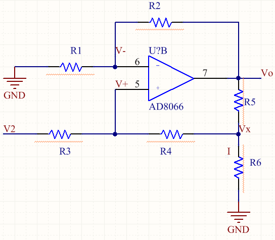

第二类电路:
根据运放虚短和虚断的概念,
设: V+ = V- = Vi
可得: Vi/R1 = (Vo-Vi)/R2
Vi = (1+R2/R1)Vo
又由虚断: (V2-Vi)/R3 = (V2 - Vx)/(R3+R4)
(V2-Vi)/R3 + Vx/R6 =(Vo-Vx)/R5
当满足 R2/R1 = (R4+R5)/R3 时, I = V2 / R5
