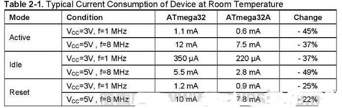

  2.1 Current Consumption
  Active and Idle mode current consumption of the device has been reduced significantly. The tables below present typical current consumption figures at room temperature. All values are taken from device datasheets, unless otherwise noted.

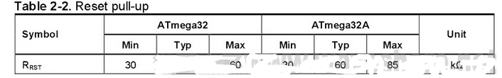

  2.2 Reset Pull-Up
  Table 2-2 summarizes the differences between the reset pull-up of ATmega32 and that of ATmega32A.
