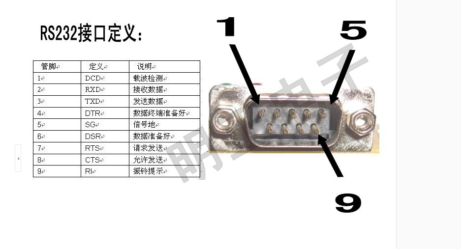

USB(fet232rl)转串口(九针的),我想全部用光耦隔离,用pc817,怎么实现啊!?
