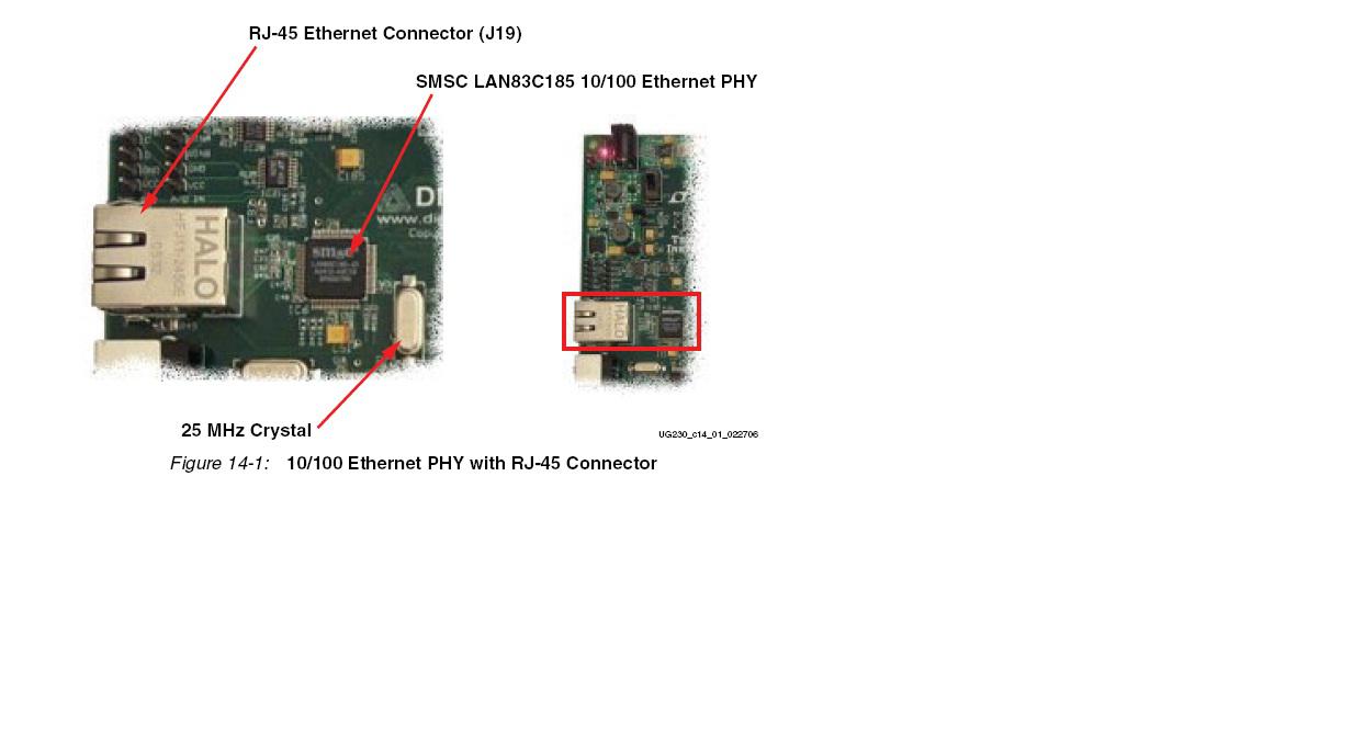

我在用
Spartan-3E FPGA
Digilent入门套件板
我想使用这块板的以太网端口
我没有从这个板的25 MHZ晶体获得时钟,用于以太网端口。
我的问题是
1.我如何验证这种晶体是否产生了我所需的时钟。
目前我已经查看了Chipscope,我看到的是50 MHZ的主板时钟,但是这个时钟的持续时间为1(高)
2.其次为什么以太网有单独的时钟。
为什么它不使用50 MHZ的主板主时钟。
图片已附上

I am usingSpartan-3E FPGAStarter Kit Board of Digilent
I want to use Ethernet port of this board
I am not getting clock from 25 MHZ crystal of this board which is for ethernet port.
my questions are
1. How can i verify that this crystal is producing my required clock. At present i have checked on Chipscope and i am seeing the board clock of 50 MHZ but this clock is giving continuous level of 1 (high)
2. Secondly why there is separate clock for Ethernet. why it does not use board's main  clock of 50 MHZ.
Picture is attached
