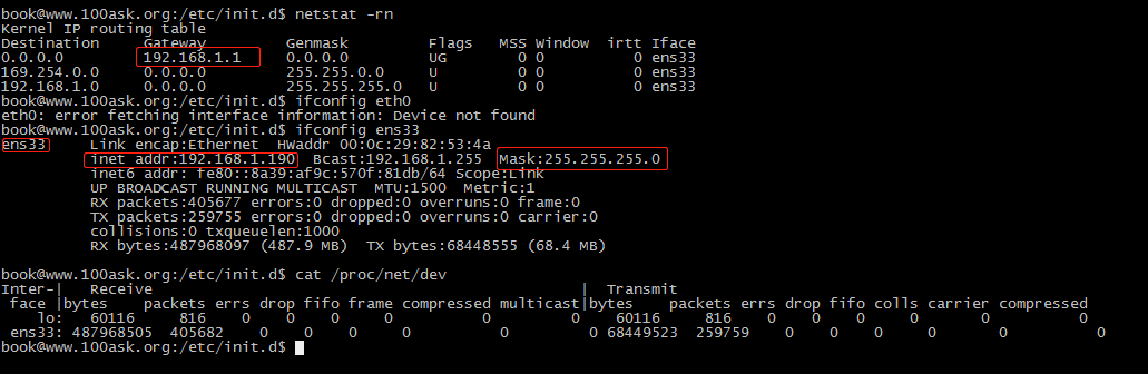

linux虚拟机网络配置如下:
名称:ens33;ip:192.168.1.190;网关:192.168.1.1;掩码:255.255.255.0

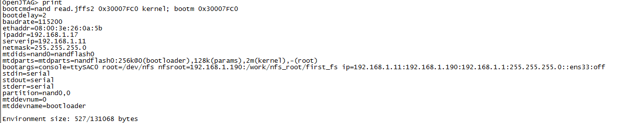

开发板相关参数:
设置启动参数为:
set bootargs console=ttySAC0 root=/dev/nfs nfsroot=192.168.1.190:/work/nfs_root/first_fs ip=192.168.1.17:192.168.1.190:192.168.1.1:255.255.255.0::ens33:off

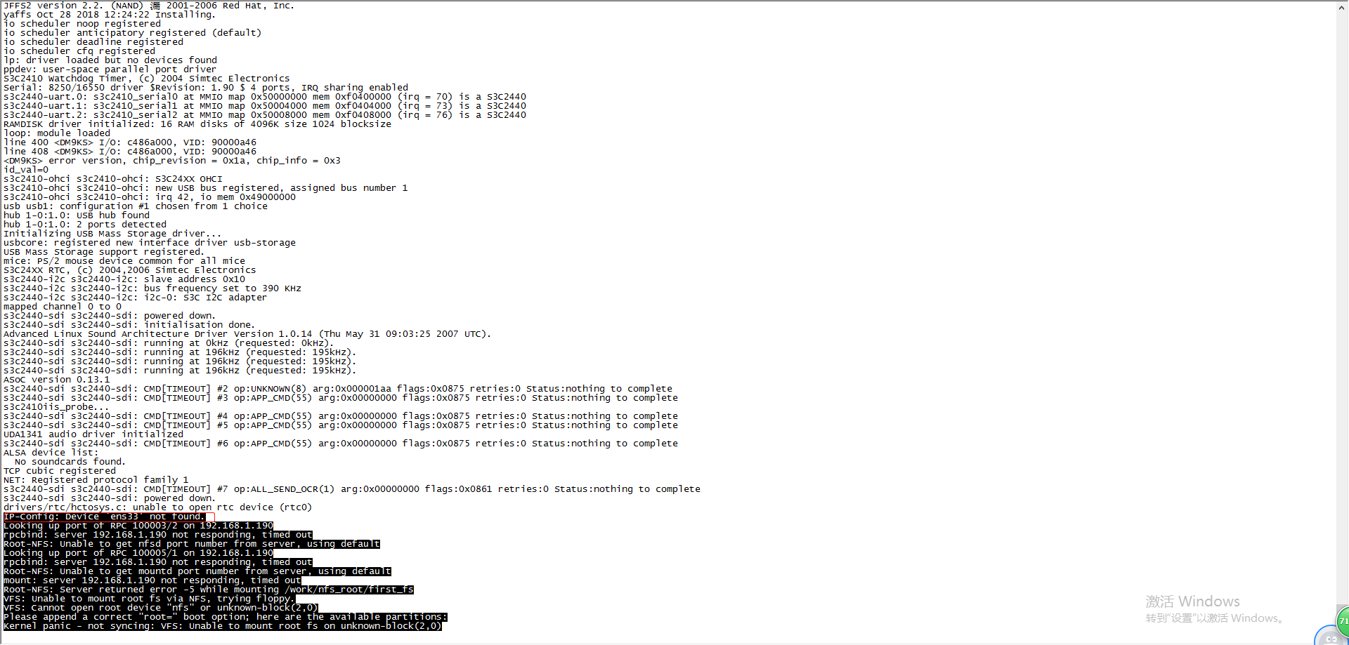

串口提示消息:
IP-Config: Device `ens33' not found.
Looking up port of RPC 100003/2 on 192.168.1.190
rPCBind: server 192.168.1.190 not responding, timed out
Root-NFS: Unable to get nfsd port number from server, using default
Looking up port of RPC 100005/1 on 192.168.1.190
rpcbind: server 192.168.1.190 not responding, timed out
Root-NFS: Unable to get mountd port number from server, using default
mount: server 192.168.1.190 not responding, timed out
Root-NFS: Server returned error -5 while mounting /work/nfs_root/first_fs
VFS: Unable to mount root fs via NFS, trying floppy.
VFS: Cannot open root device "nfs" or unknown-block(2,0)
Please append a correct "root=" boot option; here are the available partitions:
Kernel panic - not syncing: VFS: Unable to mount root fs on unknown-block(2,0)
在保持启动参数为set bootargs console=ttySAC0 root=/dev/nfs nfsroot=192.168.1.190:/work/nfs_root/first_fs ip=192.168.1.17:192.168.1.190:192.168.1.1:255.255.255.0::ens33:off

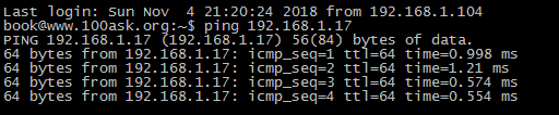

开发板ping虚拟机是没有问题的:

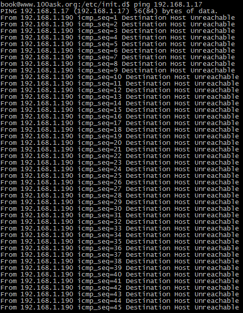

但是虚拟机ping开发板有问题:
将开发板启动参数改为set bootargs noinitrd root=/dev/mtdblock3 init=/linuxrc console=ttySAC0,115200后,虚拟机ping开发板没问题:
