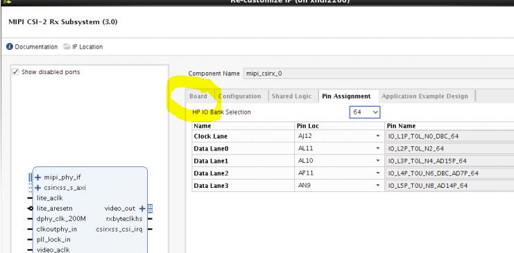

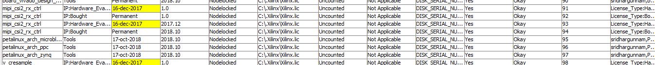

Thanks for the reply.
The IP are up to date. Do you think there any other issues?
One thing I observed is that when customizing the IP, I didn't see the tab for board, which is present in the figures shown in the documentation. Please find them in the attachments.
I was trying to use mipi_csi2_rx with IMX274 camera sensor. I instantiated the IP in vivado, did "generate output products", then tried to open the example design project, as I am unsure of all the connections to this IP block. Do you think there is a better way to use these IP's? The mipi_csi2_rx IP documentation is not clear on how to build example design.
