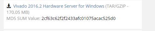

试图安装hw服务器2016.2
我需要通过vivado 2016.2编写位文件和ltx文件。
尝试仅安装hw_server:http://www.xilinx.com/support/download.html。
某些目录是在C:/ Xilinx下创建的,但是如何打开hw管理器
以上来自于谷歌翻译
以下为原文
I need to program bit file and ltx files through vivado 2016.2. Tried installing only the hw_server at https://www.xilinx.com/support/download.html. Some directory is created under C:/Xilinx but how to open the hw manager

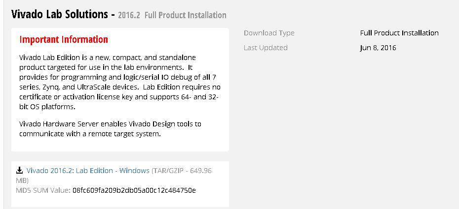

Hi this is what i have installed. Will Hardware manager be installed with this. I want to program from local machine. vivado 2016.2 requires installation size of around 32GB. I do not have that much space free.
刘鹏
2018-12-18 11:40:15
@ hulk789No,您已经安装了硬件服务器而不是硬件管理器。
您必须安装vivado实验室工具。
-Pratham ------------------------------------------------
----------------------------------------------请注意 - 请
如果提供的信息有用,请将答案标记为“接受为解决方案”。给予您认为有用并回复导向的帖子。感谢K-
以上来自于谷歌翻译
以下为原文
@hulk789 No, You have installed hardware server not the hardware manager. You have to install vivado lab tools.
-Pratham
Kindly note- Please mark the Answer as "Accept as solution" if information provided is helpful.
Give Kudos to a post which you think is helpful and reply oriented.
