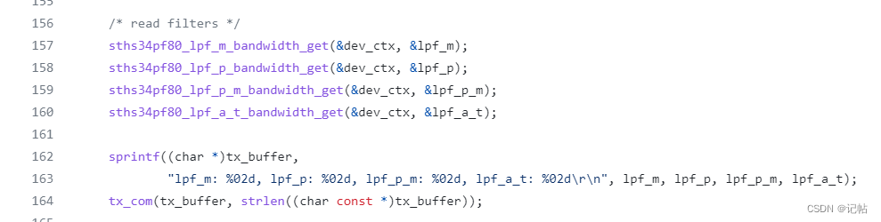

案例中只是对滤波器进行了读取以及打印。
人体检测
修改后如下所示。
/* read filters */
  sths34pf80_lpf_m_bandwidth_get(STHS34PF80_ADDRESS, &lpf_m);
  sths34pf80_lpf_p_bandwidth_get(STHS34PF80_ADDRESS, &lpf_p);
  sths34pf80_lpf_p_m_bandwidth_get(STHS34PF80_ADDRESS, &lpf_p_m);
  sths34pf80_lpf_a_t_bandwidth_get(STHS34PF80_ADDRESS, &lpf_a_t);
printf("lpf_m: %02d, lpf_p: %02d, lpf_p_m: %02d, lpf_a_t: %02drn", lpf_m, lpf_p, lpf_p_m, lpf_a_t);
